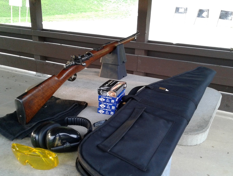

I don't know about the #1 but my 1895 Chilean likes 140 gn. bullets.
Very nice Mauser there. Usually they're beat to he!! but yours looks in very good condition. My Chilean also like 140 grain and heavier. It's been sporterized some time in the earthy 70s into a Mannlicher with 20" barrel. I picked it up in a Clovis New Mexico gun shop in 1972 for the princely sum of $60. Still use it today.
Do you have any pics of your sportized mauser?
