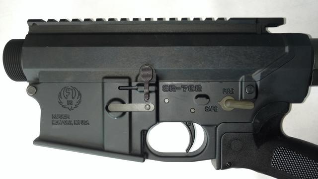

Judging by the overwhelming responses to my original post (you Ruger guys are a loquacious bunch) -- here's the follow up...
I was inspired (actually kinda jealous) by my buddy's new .308AR rifle build and decided to build a custom upper for my SR-762. After researching the interwebz and reading through the epic threads here on rugerforum, I found out that Matrix Aerospace makes the SR-762 uppers and lowers for Ruger. On Matrix's website they only sell matched upper/lower sets, so I called them and they will sell you a stripped upper by itself. But with my google-fu skilz , I found another source for a stripped upper that was more economical. Anyway, the upper arrived yesterday and here it is mated to my SR-762 lower:
Woohoo! Perfect fit and looks exactly like the upper that came with my SR-762. Now, excuse me, but I've got some shopping to do to finish out my build. I'm thinking of putting on a longer barrel for sure. Any suggestions for barrel, handguard, etc., is appreciated.
Side note: For you more astute readers, you're probably wondering what the @#$%& is wrong with my pistol grip ?! For your information (cough "CalDOJ" cough) that is NOT a pistol grip -- that's a Thordsen stock. Unfortunately for me, since I live in Commiefornia we have to put up with all kinds of gun restrictions (it's for the chilrren!). Anyway that's besides the point of this post and I only show part of it to not scare the faint of heart as to what gun laws we have to put up with -- that's a different story.

Well here it is boys and girls!
My Matrix Aero upper build on my SR-762 lower (with Thordsen stock ). I had originally wanted to build the upper with a 20" barrel, but my buddy whom is also building a .308 AR gave me his 18" barrel (he didn't like how it looked and the weight) -- who am I to turn down free stuff! Man, I love friends with more money than sense !! Now I just need to find time to take it out to the range...
Many thanks to all with their input and encouragement but special thanks to Tacky for his guidance and recommendations!

Here ya go - my Matrix upper build specs:
Barrel (gifted by my buddy): 18" Ballistic Advantage 1:10 twist
BCG: Fail Zero Carrier and Bolt with NiB coating
Gas Block: SLR Rifleworks Sentry 7 Adjustable GB
Muzzle Device: VG6 Gamma 762 Compensator
Charging Handle: Strike Industries CH w/ extended latch
Handguard: Stag Arms 16.5" MLOK (got this at the LGS because I had a gift certificate and it was the lightest HG they had in stock [11oz] at that time)
BUIS: Magpul MBUS Pro offset front & rear
