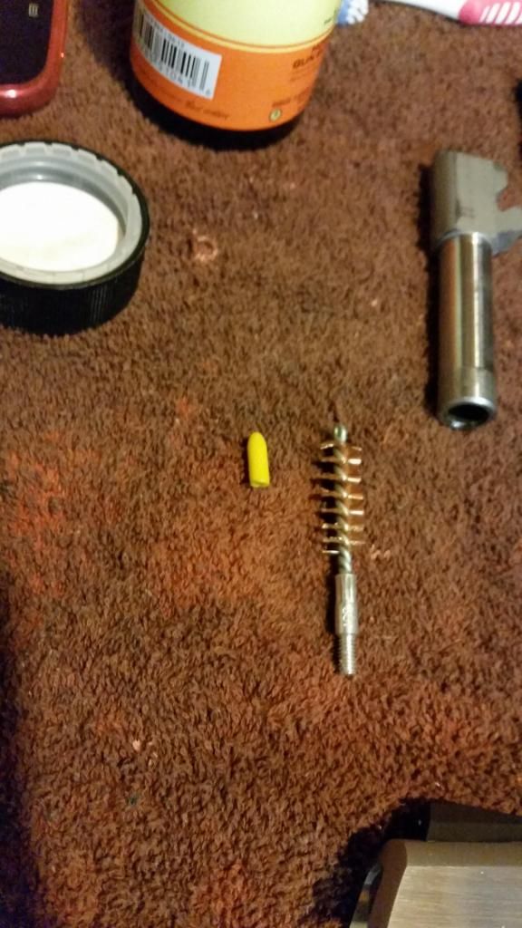

First let me say I'm completely new to firearms including cleaning them. Just thought I'd share a tip I did to my bronze brush. I'm not sure if it's necessary but I had them laying around so I figured I'd try it out.
I just bought a 22 piece Winchester cleaning kit from Walmart.

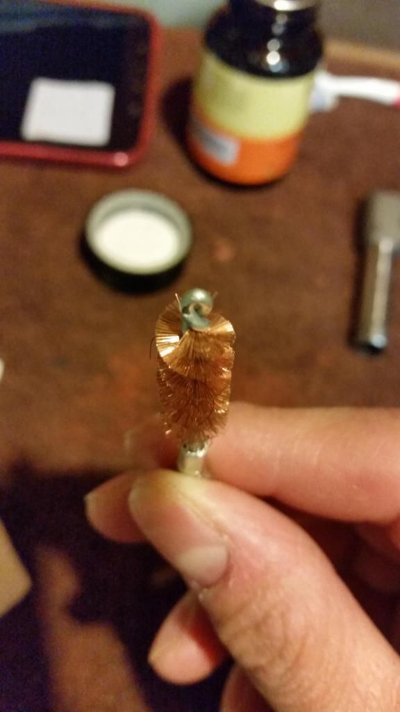

The bronze brushes have an exposed piece of the steel wire sticking out of the top. Just thought it had the potential to scratch the barrel if it went in at the wrong angle or brushed too aggressively.[IMG][/IMG]

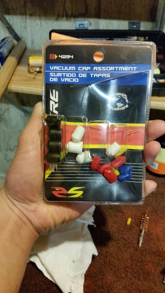

So I had these laying around that you can get at an auto parts store.[IMG][/IMG]

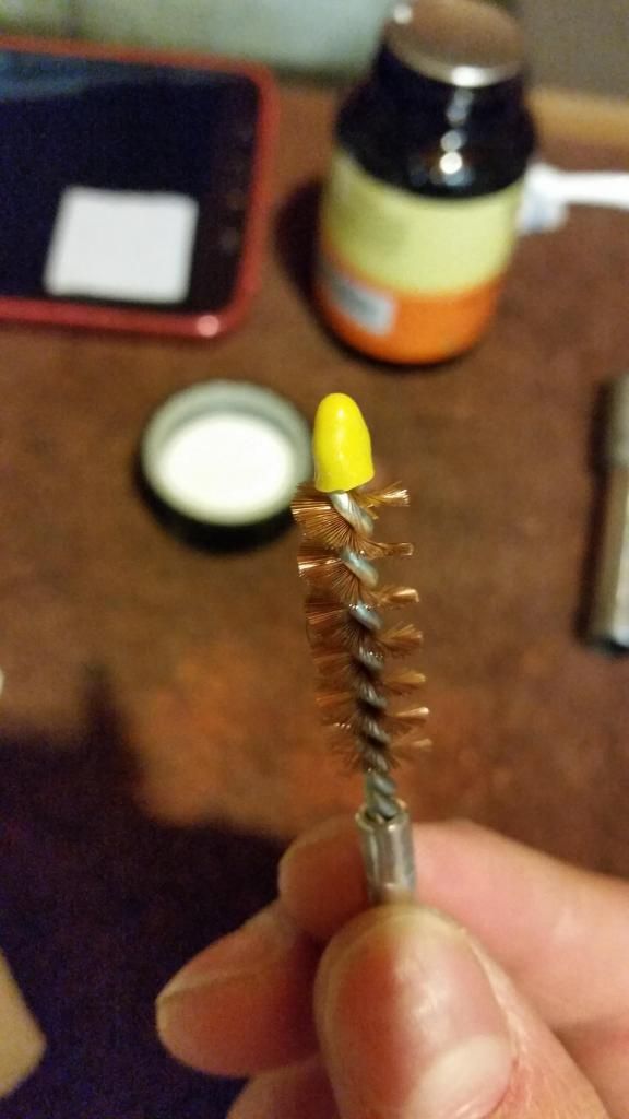

So basically just found the one that fit and cut it down a bit to fit snug on the brush tip. [IMG][/IMG]

Didn't budge while cleaning and didn't worry about scratching anything with that steel tip. Hope it helps but like I said not sure if it's necessary.

I use Pro-Shot brand which doesn't have that steel core. Instead it has a brass core.

Good idea as long as they can take the chemicals.

It was a cheap set so I didn't expect great brushes. But they will work for now until I can get something better. I think it should hold up. I had to do the same thing to one of my wheel brushes for my car to avoid scratching up my summer wheels. That one has been doing fine so far.

G35, The tip protectors won't hurt anything but they really don't have a valid function. Assuming you use the proper size bore brush, the steel wire tip will NEVER touch the bore.
