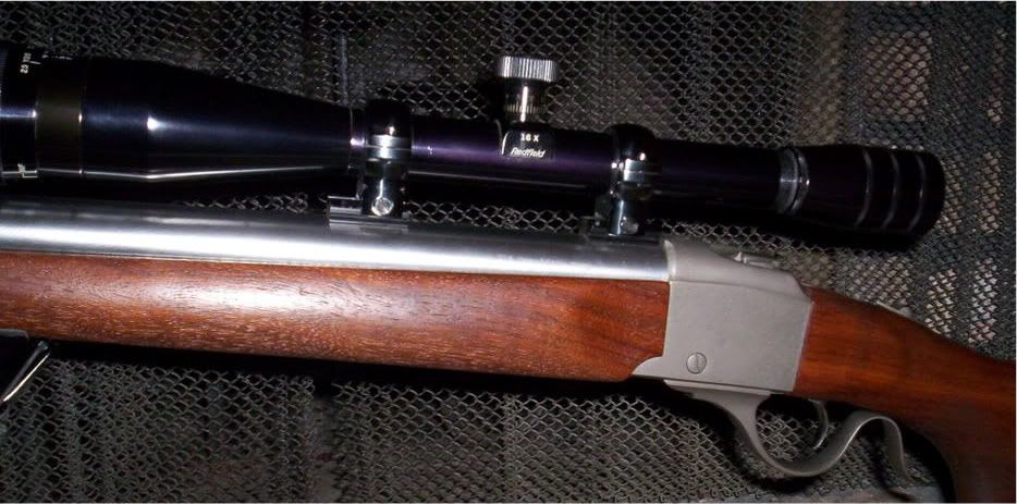

Wunbe,
Both bases are Weaver #85, which is listed as the rear base for the No.1 and No.3. I use it for both front and rear because the barrel is 1.200 dia. for 5 inches before starting to taper. The Krieger .20 cal barrel is #18 contour and the Pacnor is Target Weight contour. The Shilen #7 contour barrels come 1.250 dia. for 4" and after the gunsmith turns that down to 1.200 dia., it has about 5" of straight. Here's a couple more pics of the scope mounting. I had this No.3 rebarreled in .219 Wasp back in 1993 with a Shilen #7. I had the scope bases 4.0" apart which puts the front base too far forward. Since then I've had them 3.25" apart. Now I can mount the scopes with the turret almost against the rear ring. That works for me shooting off a bench or prone. After 6000 rounds I had this No.3 rebarreled to .204 Wasp a couple of years ago.

I have the exact same Redfield 6400 16X scope. I just used it to shoot some nice 50 and 100 yd. groups with my Japanese remake Win. 52B sporter

gewehrfreund,
I used it on a couple different rifles on PD's, then relegated it to target work for a while before sending it on down the road. Sold it on the Varmints Den forum to a guy in Nebraska. I sent it to Redfield back in the 90's and they cleaned it for $7 return postage. Always liked the plumb colored blueing. The lack of reference points on the fine crosshairs made it harder to use on the windy prairie than a scope with duplex or mil-dot.
