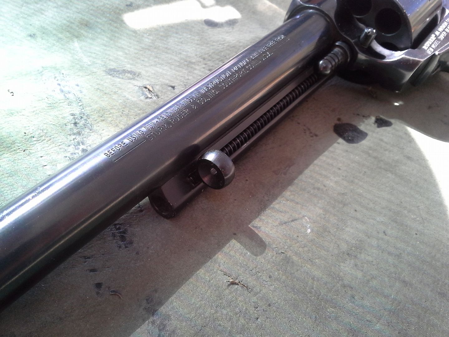

Mr Turnbull's work is of the highest quality, on vintage Winchesters, Colts and also Rugers..I can attest personally
I sent my Old Vaquero Birdhead back to Ruger to replace the "case color" turned brown into bluing in large part because I had several projects going on with Mr Bowen and the Bridshead in 45 Colt with anything except Cowboy loads too "interesting" on recoil to shoot much...the RUger bluing expeditious and perfectly acceptable...and free I might add...since purchasing I now restrict purchasing Rugers to Bisley
