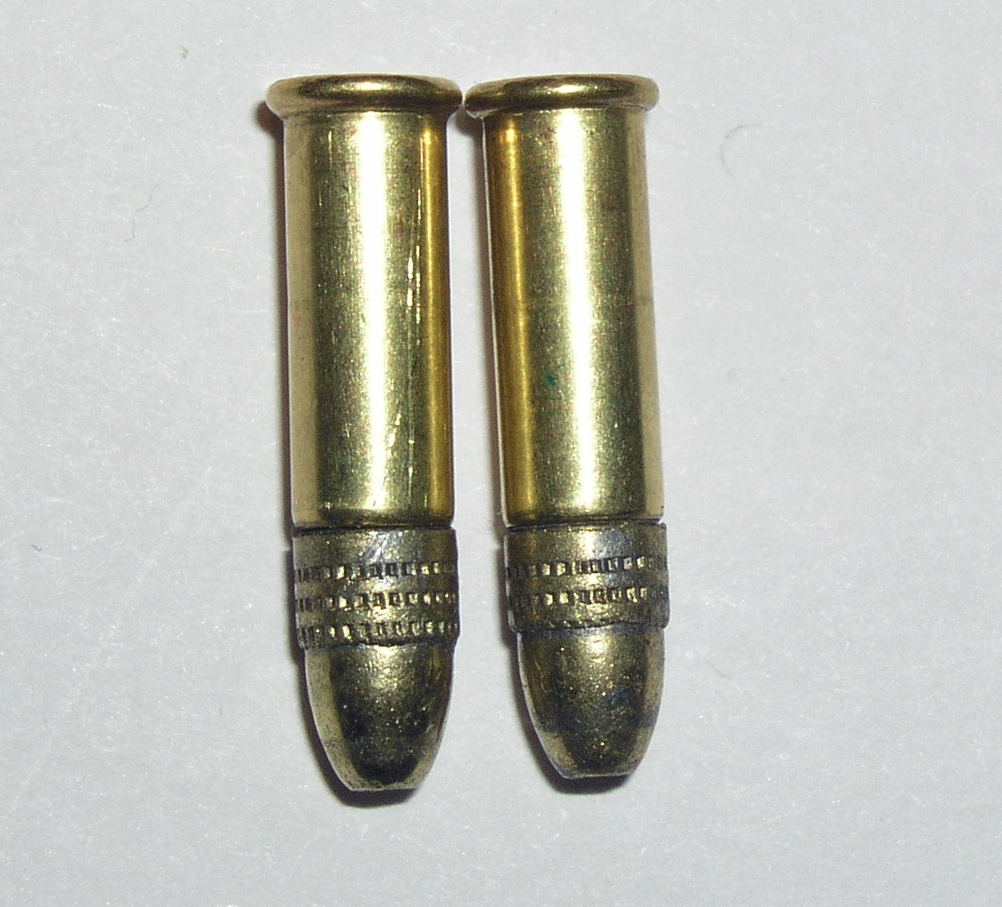

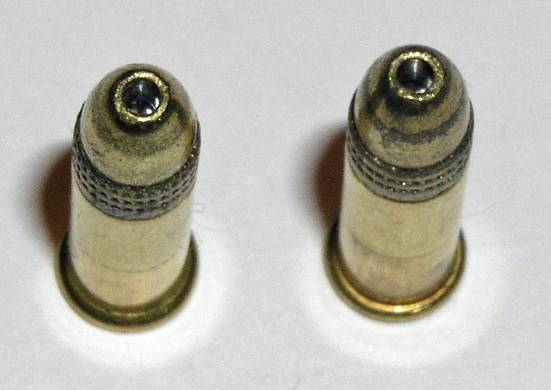

I took a few pictures this morning of 2 rounds of Remington Golden Bullet. The one on the left (in both photos) caused severe binding (would not advance) and caused me to remove the cylinder to get it out. The bullet on the right worked properly.
If you look carefully, you can see that the lip of the rim is not well defined causing it to not insert fully into the cylinder.
I would not be surprised if similar manufacturing defects in the cheaper bulk ammo is also the culprit in semi-autos malfunctions, especially FTE.
In this photo you can see that the flash is not reflected as much due to the radius or curvature in the lip area of the defective round on the left.
