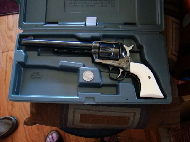

BlkHawk73, Thank you for your reply. Yah,you caught me I miss spoke. I did mean to say serial#. I'm sure my parents will be glade to hear there was low numbers produced. I'm not sure what they paid for it and I don't feel right to ask. But they wanted one for awhile now. It's not their first revolver so I'm sure they checked it over good. They are happy with the purchase and that's what count's. Here's a picture of it. [IMG][/IMG]

Looks good.
I would be happy with it in my stable.
