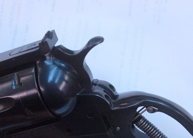

The result is that the SBH hammer base doesn't fill the back strap ears in a post 1998 grip frame.
Mike Campbell photo.
