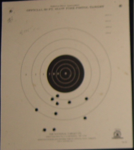

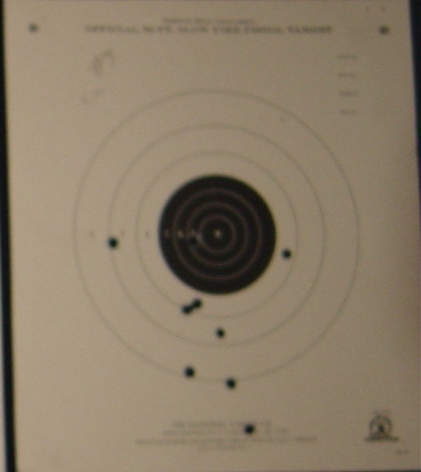

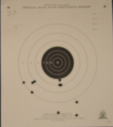

Results! Sort of...
I shot all three batches this morning. It was about 43 degrees, no wind. Chrony was probably 8ft from the muzzle. 5 rounds from each batch went over the chrony. Between each chrony and accuracy batch I pulled a boresnake once through each chamber and the barrel.
Load #1: 1247fps avg
Load #2: 1291fps avg (there was one hottie at 1330 which opened this up a bit)
Load #3: 1248fps
Except for the one hot load that went over the chrony throwing off #2, they're all right on top of each other. These are the hottest homebrew loads I've chrony'd. I once shot 17gr of Lil'Gun, but didn't chrony them. Those kicked enough to whack my middle finger with the trigger guard. I bet they were clocking ~1400fps, though Lil'Gun burns slowly, and the extra may have mostly been wasted. These were manageable. I'd rather shoot 180's at 1200 than 158's at 1400.
I shot for groups at 25 yards, 10 rounds from each batch, one target per batch. I used a front sandbag over which I rested my wrist right at the heel of my hand. Targets were NRA 50ft slow-fire pistol targets. Sight pictures was a 6-o'clock hold, and the gun has always been sighted in for POA==POI since it's more suited to hunting than bullseye shooting.
I apologize for the blurry pix - I don't have the patience for the media-swapping game any more tongiht. Besides, these convey the necessary information.
#1: 4.125" c-t-c
#2: 5.75" c-t-c
#3: 5.75" c-t-c
The skinniest rounds were the tightest, though I don't think a mere inch - 20%, roughly - out of a handgun at 25yards is indicative of an ammo difference. I basically rate these all the same, I think.
What to conclude??
I suck at shooting this gun...?
These groups probably equal what I could do from a rest with my 6" .38spl at *50* yards.
I feel like the testing hasn't proven anything technical, just that I need to practice more and find a better fit with the gun.
Notes from today:
1) The trigger feels like a million pounds, particularly on the bench. In reality it's 3.4lbs. I just measured it with my Lyman gauge. It has some travel, of course, due to the transfer bar. Maybe I need to smooth some of those sliding surfaces.
2) The rounded edges of the front sight cause sighting problems depending on the light. I've always known this. True target sights have rather sharp rear edges.
3) the grip is a bit narrow/short for my hands, which results in a less than perfect trigger pull/position.
What now? New grips, possibly, as discussed on another thread. I with the front sight blade was interchangeable like on the stainless models and the GP100. I'd put a target blade in there in a second.
Any advice, APatriot?
After contemplating these targets a bit, I took the coaster off my desk and laid it on top and drew some 3.5" circles. Interesting:
* On all targets, I can touch (bullseye scoring...) 70% or more of the holes with a 3.5" circle.
* On targets 1 and 3, a 3.5" circle at POA covers 60 and 70% of the holes (target 2 has three on top of each other exactly at POA, and the rest are a mess)

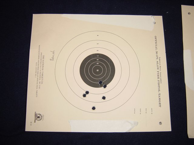

Ok, True Believers, here's the latest report!
Today was gorgeous.
50rds of the same 158gr bullets, no alox, no FCD, on top of 5.3gr of Universal. Why .3? Because the next and last step on that disc on my Lee Auto Disc powder measure produced 5.3 instead of 5.5.
Results AND pix:
These rounds felt GREAT to shoot. Just the right amount of pop, no unpleasant blast. They frequently fell out of the cylinder while unloading, and the primers looked perfect. Not too round, not too flat.
1025fps average, with a SD of 23 - better than before.
They shot great too, turning in @ 15yds (shorter than before):
* 2.28" from the bench
* 2.5" standing, two-hands
* 4" standing one-hand
Now I really enjoyed shooting this load, and I felt all kinds of confident. Maybe the sun helped too. The only problem was a fair amount of leading in the first 1.5" or so of the barrel. A bit in the cylinder, but not bad. This suggests to me that the bullets are a bit hard for this pressure, but frankly, I loved the load so much, that I don't want to go past 5.5gr, and is another 0.2gr really going to solve the problem? Probably not. For the next batch I will duplicate the same load, except add Alox to the bullets to see if that mitigates the leading problem enough. Or.... maybe I'll get froggy, go to 5.5 w/ alox. I don't know. One variable at a time, says the scientist in me. GET IT RIGHT NOW, says Mr. Impatient.
Thinking about this more, the mild leading in the cylinder suggests that perhaps they are bumping up to the right size, but the chamber mouths are a LOT bigger than the throat, and swaging the bullet down that much without extra lube might be a cause of leading. Hm. More pondering ahead.
And now to today's targets. The horizontal one was shot that way. I realize, of course, that 3 targets from 3 different positions is not statistically significant. However, the difference is so stark from the previous ones that I'm surely on the right track.
Without further ado:
Bench, 2 hands, wrist rested

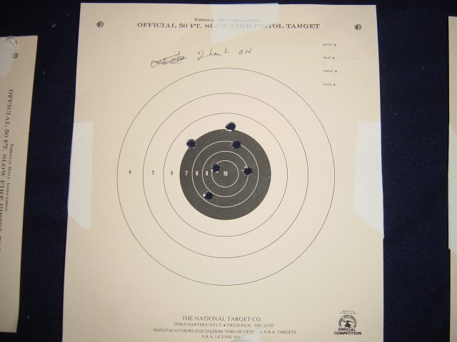

2 hands, standing

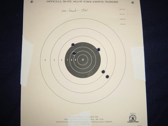

1 hand, standing. I THINK I only shot 5rds at this target (one at the berm), but it's possible I totally tossed the last one.
