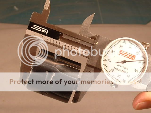

TO GET A CYLINDER OF PROPER SIZE:
In 30 years I have never installed one or heard of one that did not function and "time" correctly. They are assembly line produced to a common plus or minus tolerance. The exception and only important issue is that it has enough overall length for your frame at the front hub which is fit and sized to each individual frame window. If too long you can dress it down and is simple to 'fit' with a little stoning, usually under .005", that's not a lot. To have a gunsmith do it would be a minimal charge if you're more comfortable doing it that way.
You should take an overall length measurement of your cyl with a dial caliper in .001 of an inch and seek one the same length or longer (1st photo). A cyl with a gap as shown at the bottom arrow, in the 2nd photo below: will rub on the end of the barrel at the top arrow because it will move back and forth in the gun called "cylinder end shake" in gunsmith terms.

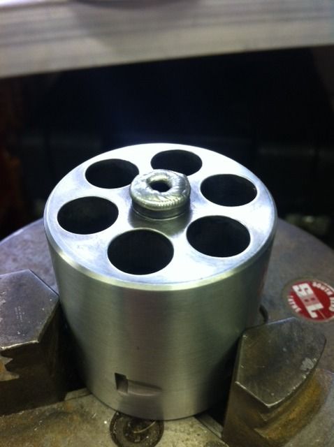

One solution for cyls that are too short is a tig welded bead and then filed to fit frame. The other is drilling out the hub, turning and press fitting a longer one:
RugerForum.com ? View topic - Is welding stainless possible?
