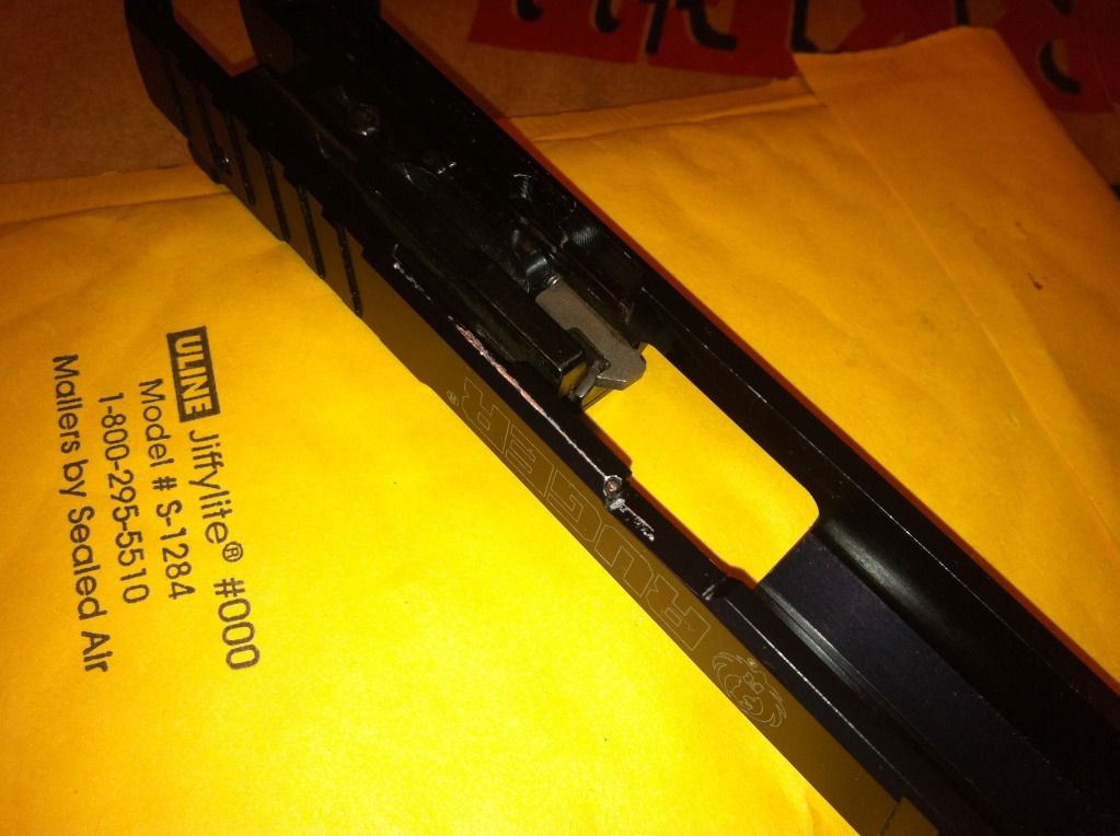

I received my guide rod and spring finally. I can't really blame ruger for the wait as it was evidently delivered to someone elses house then redelivered to me. So the first thing I noticed when reassembling the gun was that I was having a really hard time getting the slide to go on. Everything seemed OK and looked fine from what I could tell, but it just wouldn't feed on. I finally got it to go on, but disassembled several more times and have the same issue. I don't get it? It will eventually go, but it is like 20 times trying before it will.
So at the range now. First ten rounds, 4 failure to feeds and no hold open on the last round. This was the story for the rest of the day, FTF no hold open. Some mags ran OK but most had some issue at the very least no hold open on the last shot. I was shooting federal 550 bulk which previously this gun ate up and asked for more everytime. I don't get it. On three separate occasions the magazine dropped out while shooting. I know I wasn't hitting the release.
I want to really like this gun, but I am getting frustrated. It should have been flawless out of the factory and definately should have been fixed when I sent it back. So, do I send it back a second time??????

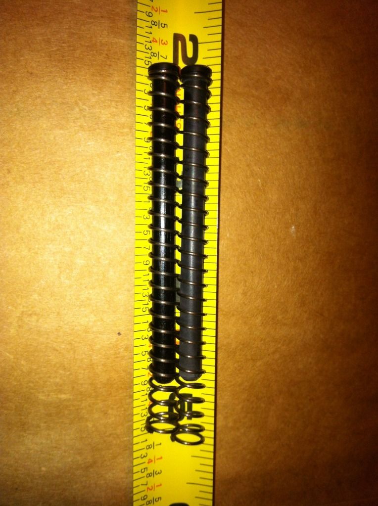

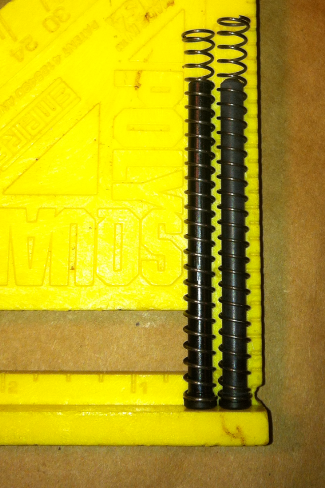

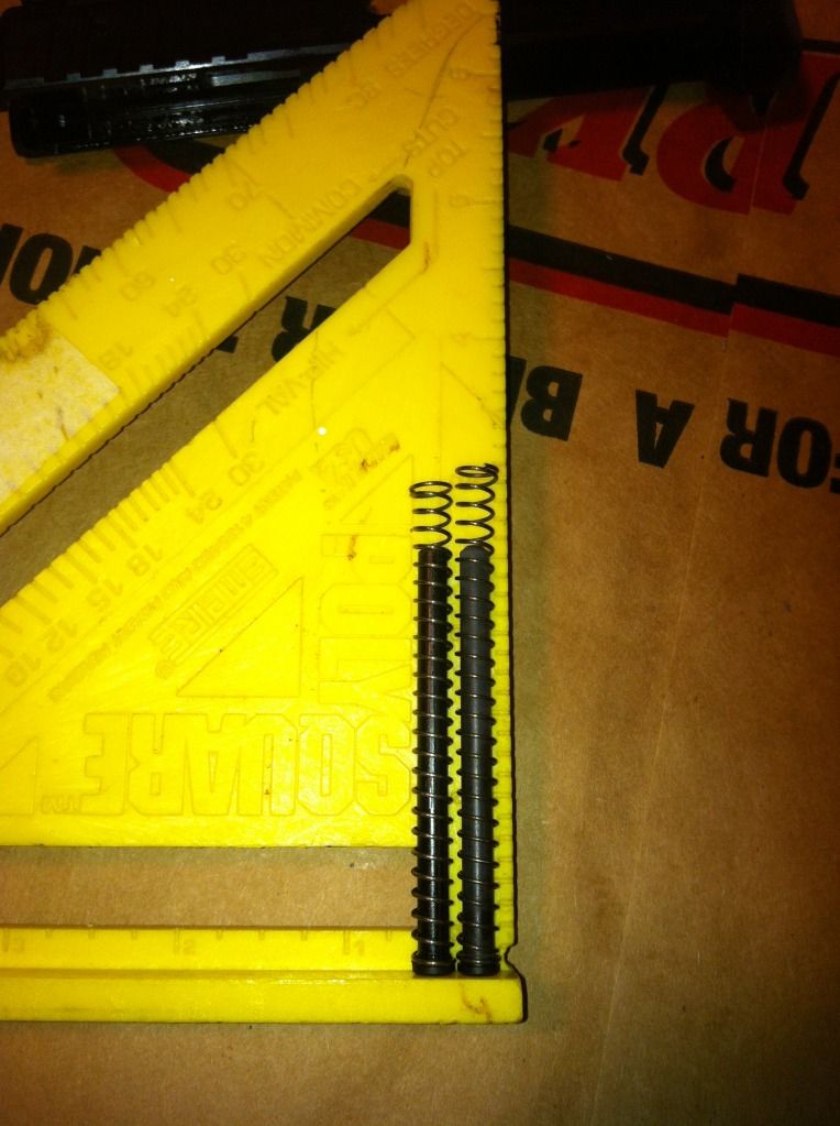

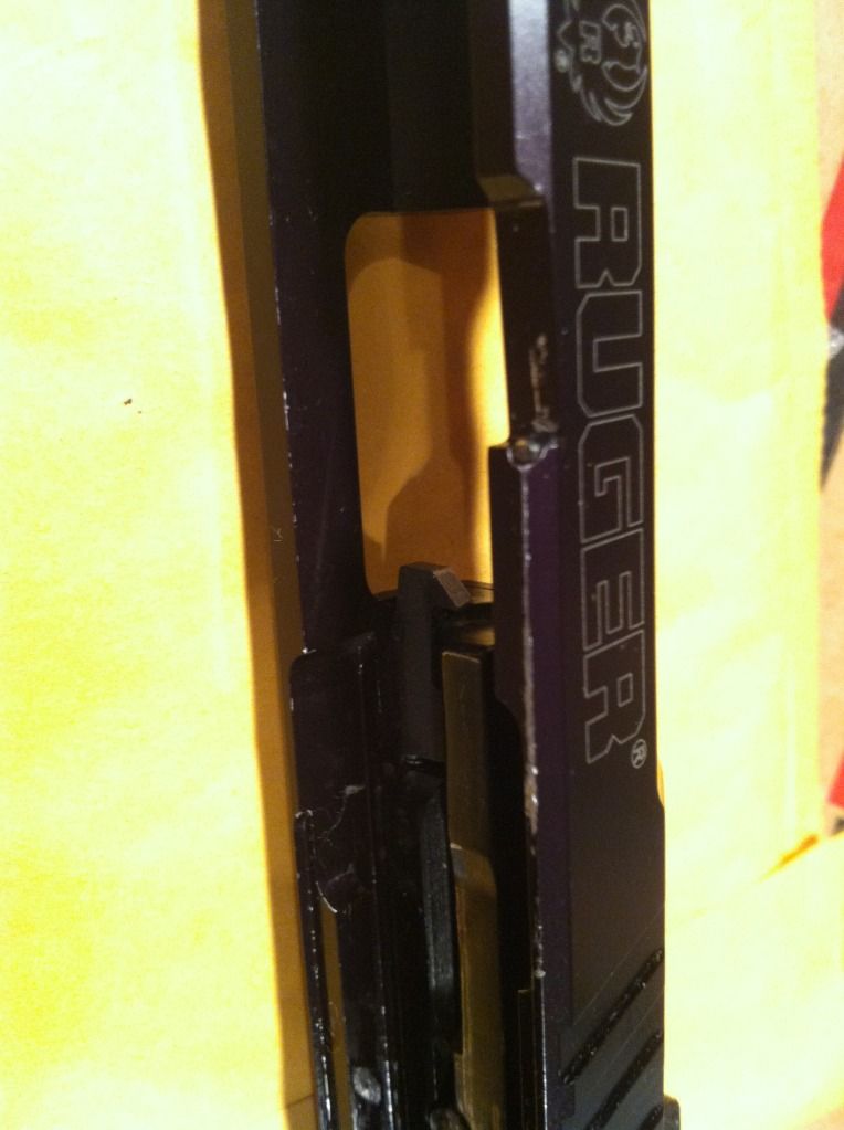

Alright, so I have some news to report.
So after my range test upon receiving my gun back from Ruger I have some findings.
1. New rod and spring to replace damaged one at base of rod.
-new spring is minimum of 1/8" longer than previous spring.
-new spring operation is guessed to me the majority of the failure to feed issues and possibly the hold open issue.
-new spring somehow caused difficulty in reassembly of slide
2. replacement slide for previous slide damage from rubbing.
-new slide shows exact same damage as previous slide, so slide was replaced, but issue was not resolved and not diagnosed as assumed when documentation was returned stating slide replacement only.
-new slide definitely shows sign of resistance when racking slide, may also be the cause of FTF and hold open issues.
3. magazine retention issue
-magazine does not like to fully seat unless hit a couple of times
-at range magazine dropped slightly out while firing several times
4.Gun reassembly issue
So that's about everything I can think of. I think I have no option but to return it back again to Ruger.
Comments or suggestion?
Thanks

Hmm strange the SR22 would have different spring lengths. When in doubt use the shorter one.
Regarding slide rubbing, make sure your thumbs aren't touching or resting on the slide stop.
