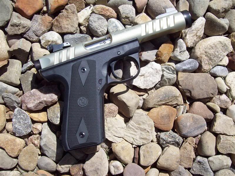

Originally Posted by gmsoapy View Post
Does the lite have a target barrel? If it does don't use Stingers in it as the casing on a Stinger is 1/10" longer than a regular LR casing. In the 10/22 manuals it says not to use Stingers in the target barrels and Ruger Tec support says not to use them in the MKIII target models. Ok for the regular barrels and the SR22's.
GM... The question was about the LCR-22, not the LITE. You are correct that Stingers and any other Hyper-V ammo SHOULD NOT be used in the Mark Series pistols, but in revolvers, its fine.
OK in this one...
But not in this one...
weblance is offline
Old June 26th, 2012, 05:49 PM   #5
gmsoapy's Avatar
Location: Las Vegas
Posts: 909
gmsoapy is on a distinguished road
OK in this one...
Sorry Weblance had a brain F--t saw your avaitar and tought Mk lite. Duh.
