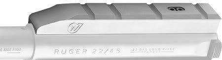

Can't answer your question but have you considered this? No drill & tap! I like mine!
Here:
http://www.jackweigand.com/
SD

I really like that Song Dawg! Any problems with the scope not staying sighted in? It looks like the dovetail holds it on at the rear. It must fit the contour of the receiver close enough that it can't move around.

rman, It's been excellent. No problems whatsoever!
It prevented my MKII from being a safe queen.

Coffee Pot, Thanks for the info and the suggestion to call Ruger and ask for the instructions. It's great own a product that the maker can & will provide help after the sale. Do you think adding a scope mount will affect the value of the piece later on? Now Song Dawg, thanks for the tip on the "no drill/no tap" rail. I went to their site and checked it out and I was very impressed. That does give me something to think about before I go drilling and messing something up. It also gives me the option of removing it to put it back to "original" so to speak!
