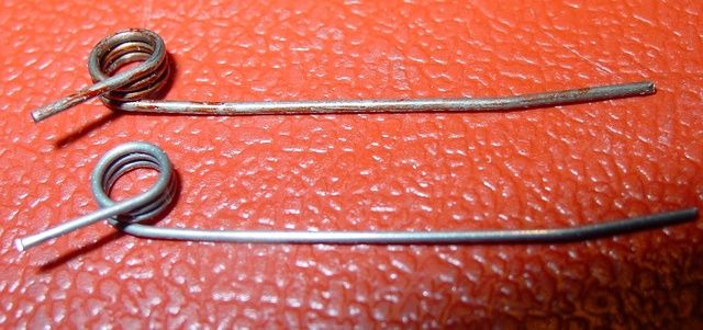

I won't get the disconnector until later in the week and was too curious about what another sear spring would be like so I stopped and picked up some .024" music wire today and make a quick spring as a test. The red spring from Ruger is .029 wire and my first test was to make one out of .024" wire as close to the same shape as possible to see the change in the trigger. The new spring dropped the trigger from 3.5 to 2.5 lbs. The reset still feels good but the real test will be live fire with one round at a time to start. When the disconnector comes in I'll put back the stock spring to be able to see if it makes any difference.
I was going to post a picture of the 2 springs but can't due to post count. I was going to try and help but it's not allowed yet.
WOW, I have worked with music wire before but to make a sear spring. I am impressed. Keep us informed. Interesting.

I received the VQ disconnector today and installed it. Unfortunately it didn't do much for my trigger pull. The pull went from 3 lb 6oz to 3 lb 4oz with the disconnector. I switched out the factory sear spring for the one that I made and the trigger is an even 2 lb now. There is still some more tweaking that I can do but I'm going to do some live fire testing of the new sear spring first. Here is a picture of the factory sear spring and the one I replaced it with.

Well, live fire went fine, rapid and slow fire there was no problem with the reset so I worked on the trigger return spring and got it to the same weight as my other MK's so now the trigger is a nice 1# 11oz so I'm finally satisfied with it. It was never going to be right without changing out the sear spring because it took a little over 2.5 lbs just to pull the return spring and then make the sear move without the hammer and main spring engaged. My sear spring was the biggest offender. The pistol was right at 6 lb pull when it was new out of the box. I don't know how this compares to other Mk IV's since this is the only example I have seen.
The person I talked to at Volquartsen seemed pretty certain that they were going to be offering a sear spring fairly soon.

Again, nice job making the spring. I had my MK4 22/45 dissembled and reassembled several times today trying to improve the trigger pull with the MK4 Volquartsen kit. No luck. I did discover that the the trigger pull is much lighter with the bolt removed. I have no idea what is going on.
Volquartsen is sending me a new disconnect. I am not having much hope that will fix the problem.
I polished the sear and hammer today also. No difference.
I was close to putting the sear spring from my MK4 Hunter (great 2 pound trigger pull) into the MK4 22/45 but did not do it.
Looking at my sear spring and your photos I notice a forward bend in the long leg of the spring. Again, I didn't take apart my standard frame MK Hunter and look at the spring.
Do you think that forward bend in the sear spring could be the issue with the heavier trigger pull? The forward bend would make for more spring pressure if I am thinking correctly.
I may take mine apart again tomorrow and straighten bend in the long leg.

Originally Posted by arlanarneberg View Post
Again, nice job making the spring. I had my Looking at my sear spring and your photos I notice a forward bend in the long leg of the spring.
That bend in the long leg won't make any difference. That little bit of bend just helps it sit better in the pocket in the left side of the grip frame. You can remove the left grip and observe its action, you can wedge it forward and back in the pocket while checking the pull and should find it makes no real difference. That long leg of the spring basically just keeps the coil from turning on the sear pin.
