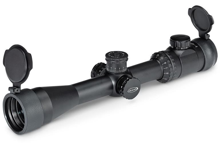

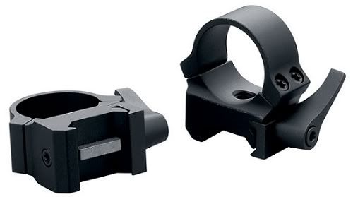

I got a set of Leupold QRW rings, and a Weaver Tactical 3-15x50 scope with the EMDR (enhanced mil dot rangefinding) illuminated reticle. I grabbed a sunshade for the Weaver as well.
This went onto the XS rail while I went on the search for a EER scope to mount up on the picatinny.

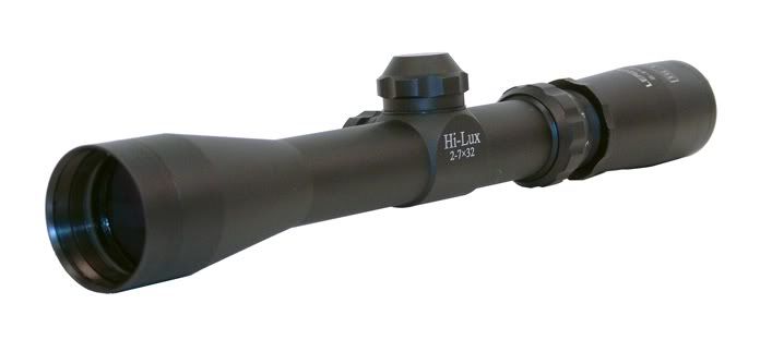

So next I went on the hunt for a good LER scout scope. This is where things got tricky. I really wanted to have a bit of variable power on the scout scope, but I had concerns about parallax issues. I am typically a Leupold/Burris/Weaver scope buyer, but at that time none of them were making a variable power LER scope, and their objective lenses were fairly small as well. Another problem I found with the scout scopes I found was that they all had fairly thick to very thick reticles, which I detest. I have always been a fan of either fine mil-dot, or German post reticles, and none of the scopes on the market had them.
My other choice, was to go with an EoTech type sight, but in the end chose to go glass, because I really wanted some magnification. EoTech's are really just an advanced set of irons to me, and the irons that came on the rifle are perfect for my intended build.
So with some diligent searching, I found that Leatherwood makes a EER scout scope, with 2-7x magnification, with a 32mm objective. Better yet, it was available with two reticle types, one of which was the German post, which I find superior for quick acquisition at intermediate ranges, without covering up your target at longer distances.
Perfect! Now I wanted to get a good quick release mount for the scout scope. In this case, I wanted something that would be very quick to take off, but still offer the chance to return to zero when remounted. So yet another search began, and I ended up going over to GG&G, and settled on their excellent AC-30 Accucam mount. I went with this mount even though it was for 30mm tubes, because they also sell an adapter for 1" tubes, giving me the flexibility to change scopes later if I chose to do so. Their accucam mount is very strong yet lightweight, and has very good repeatable back to zero tolerances.
__________________________________________________ _______________
So far, the Leatherwood scope has done very well, just a tiny bit picky with eye relief, and is what I leave the rifle wearing most of the time, on the standard Ruger picatinny rail. I love scout scope configurations, once you get used to being able to keep both eyes open you really never want to go back.
The Weaver is excellent, the illuminated reticle bright and crisp, and the EMDR reticle lets me shoot back and forth from 100 to 400+ yards quickly and with no need to touch the turrets.
