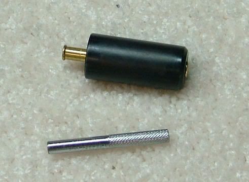

ZommyGun, It's worth a try .... if cartridges have to struggle to chamber, no doubt the bullets are getting distorted. Only a good range test will prove or disprove how much it affects accuracy ... then the next lot number of the same brand may be different. I know for sure my little 22 LR die helps ... no more feeding problems and slightly tighter groups.
Here's a photo of my 22 LR die. The right end is the Go-No go and the left end is the bullet sizer. The punch is used to push cartridges out after they get sized.

I was going to ask you today what length of barrel I would need to make a die like yours...was hoping it would be less than or equal to 2"...have an 18" factory barrel that I would not mind cutting to 16" but would not want to render useless forever under SBR...
So that part has been answered...
Next part is what do I need to do the chambering...and how easy or more to the point how much shop time would a gun smith need to make one for me if I gave him the barrel...I could have it cut...crowned for a usable 16" barrel and have him make the die out of the cut-off piece...
YES/NO...maybe...???
