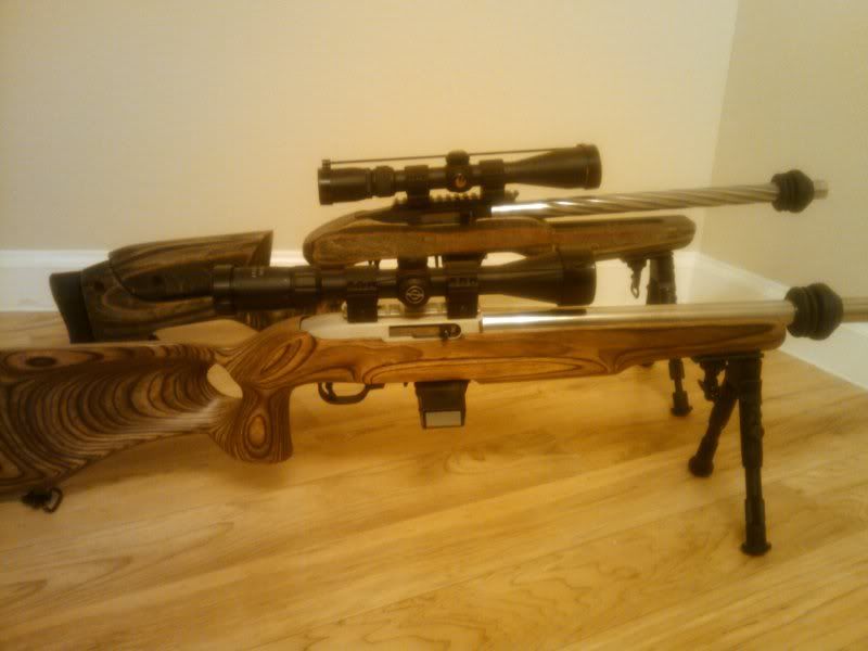

(rear) FA Ent Stock (Reworked)
KIDD Reciever, Bolt, Pins and Buffer
TI Trigger Group
Volq Ejector
Hi Desertdog 16.5" threaded helical fluted barrel
UTG SWAT profile bipod
Uncle Mikes Quick Disconnect Sling Swivels
Alangator Trimag
Limbsaver Resonance Reducer
Nikon 3-9x40mm Prostaff Scope
(Front)
Stock Ruger 10-22 with
Boyds Nutmeg Blaster Stock
KIDD Buffer
UTG SWAT profile Bipod
Uncle Mikes quick disconnect Sling Swivels
AR-7.com 20" match grade barrel with compensator
