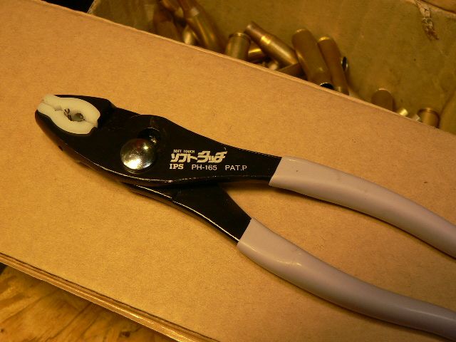

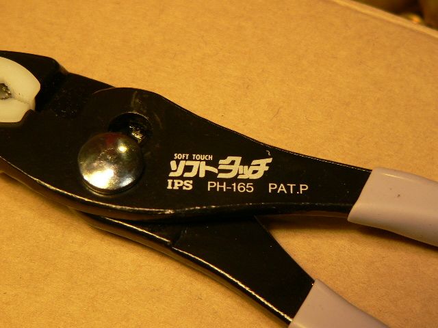

Close up of pliers with brand and Part #
Pliers full view
On the lower deck at 10 oclock start w/military de-crimp then 12 oclock is small primer pocket brush OR at 2 oclock is the large primer pocket brush then to 5 oclock inside chamfer and 7 oclock outside chamfer
this rig turns a very low RPM's but just a touch on the decrimp,quick 360 degree wobble on the pocket brush, flip the wrist to touch and go on both the inside n out chamfers ...then top deck is NOT powered ..just case neck brushes with wells for dry lube
the pliers DO NOT MARK the brass and the amount of clamp pressure to keep the brass from spinning at the two chamfer stations does not dent brass ....but to make my grasp even more relaxed at the two highest torque positions (chamfer) I got the habit of just placing my off hand finger on the case head
rebuilt shoulders and autheritic hands ..still I can do the 5 complete prep steps 6 brass per 60 seconds loafing
It used to take me a week of nights with a lap full of brass doing a 1000 brass all by hand ...enter the RCBS prep station and that time fell to ... off and on a a couple of days but had to wait for my hands to stop the pain ...enter the non marring pliers ...3 hours to do 1000 brass [assuming my attention span lasts that long ha ha! ]
Bear
