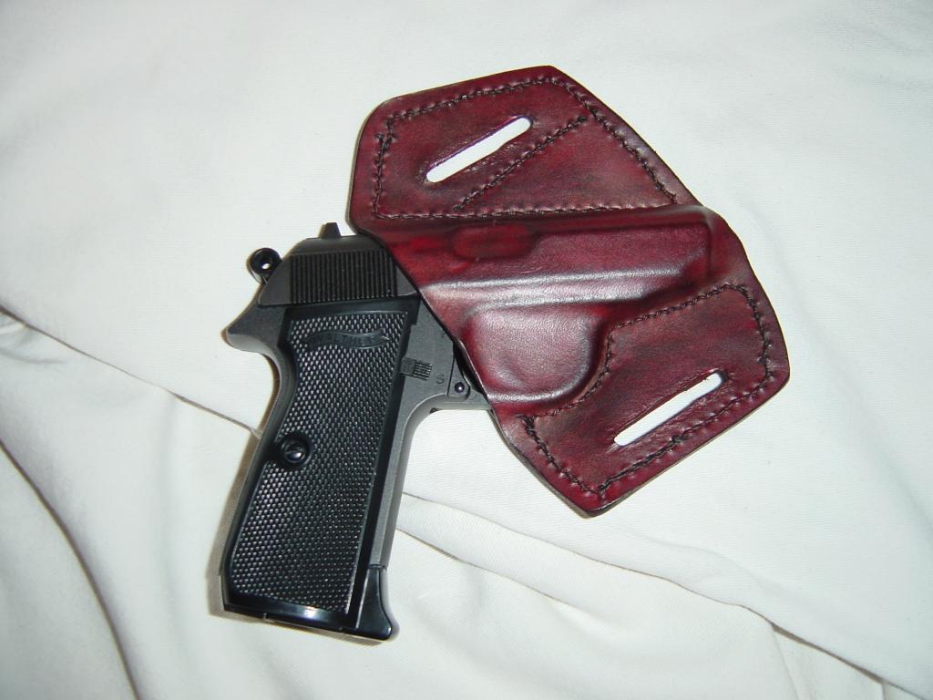

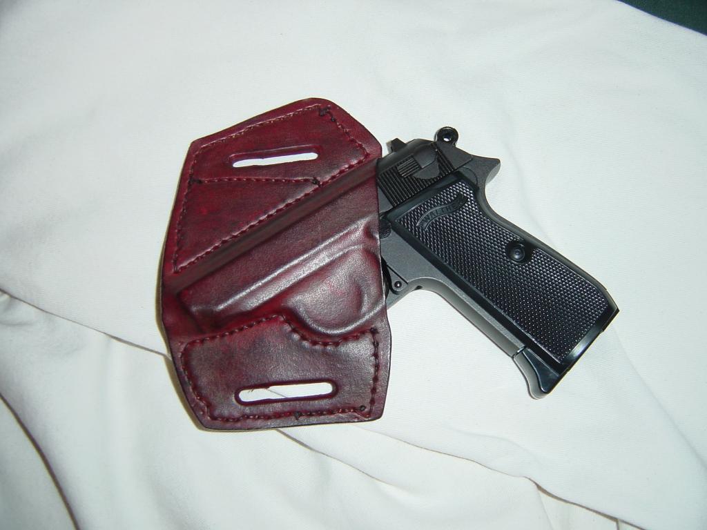

Hey Folks, here's another one.
My partner and I are trying to spin this into a low-volume business, and to that end were experimenting with some cobbler's equipment we were recently offered access to. I don't recall the name of this stitching machine, but it sure is intimidating.
I whipped up a simple pancake pattern for this PPK air pistol, and brought it to the cobbler's shop. He stitched it using his mondo machine, which made short work of what is usually a slow process. However, the machine does have some.... ideas of its own. It clearly requires an expert to operate, and is subject to some stitch failings. In the end, we're going to stay with hand-stitching for the time being, but it was an interesting experiment. No pre-punching was required. The machine uses two different threads for the top and bottom, and has plenty of tension. You can see in the pictures where the stitching machine went awry.
Lastly, my partner finished the holster first in "Ox Blood" colored dye (too pink) and then several applications of progressively darker dyes and, I think, some sno-seal.
The photos don't quite do the finished surface justice.
This was just a demo for us, and it was a very useful experiment.
We have our first custom holster order, and it's in mold now.
A Ruger LCR!
-Daizee

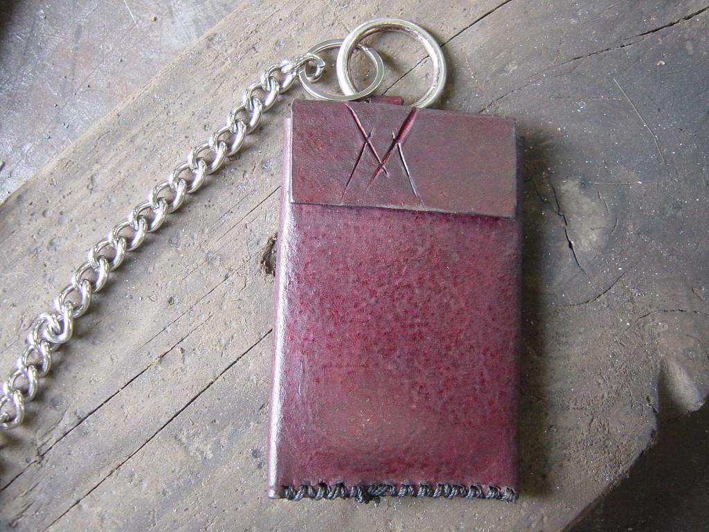

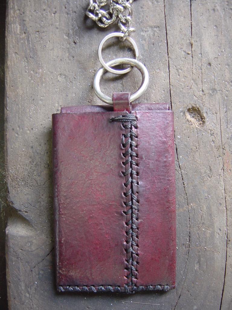

My partner made this wallet for herself over the weekend, experimenting with some new ideas, and matching her gunbelt and the above holster. That's her studio mark (Valkyrie & Muse) in the top flap. Her pictures are clearly better than mine.... same camera. She recently had a show of handgun portraits up in Philly, including a couple of the ones featured earlier in this thread.
-Daizee
