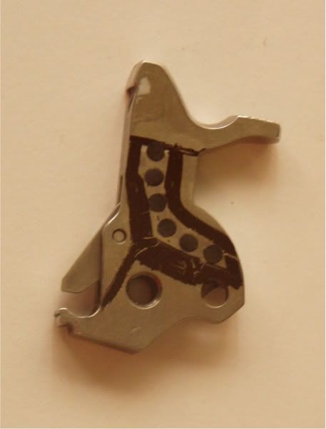

the ")" I was talking about few posts ago is in yellow
If I had to do this again I WOULD NOT GO for an HOUR GLASS shape as its very dificult to keep both sides simetrical if You are using a grinder (as seen on my pics on prev pages) If I had do it again I would grind the part marked in red, no drilling, not anything else, just dremel/grind it out, than give it a brushed or polished finnish and your done. that should be at least 10%-15% improvement if not more.
And than there is the area on the bottom of the loch ness monster I indicated with arrows and I am wondering what kind of possibilities are hiding there

PaPaPork,
Outstanding. Wow. I hadn't given any thought at all to the area you point to in blue.
I'm asking for clarification for the following you said in this last post: " . . .If I had do it again I would grind the part marked in blue . . " Did you mean red? I say this because then you speak of your blue markings again as if you were going onto something else. POST CORRECTED.
I like your idea alot. It's work that a kitchen gunsmith can do slowly and carefully - all the while he can stop and put it back in his gun and still fire it. He can stop at any time and be done with it.
As for my drill holes appearing too small. I was careful in measuring my margins for error. Unless a person is comfortable and feels 1/32" is as wide as a 6 lane highway to do work in, I'd stick to my picture. Remember, I want to be sure I don't get too close to: 1) the hammer dog plunger & spring tube; 2) the hammer dog slot; 3) the edge of the frame; and 4) stop close to the spur. It really doesn't leave much room to do much. You can see that in my first photo.
In my previous post in this thread I suggest using a couple of sizes greater than 1/8" but after drawing it more carefully it came down to 1/8". I guess I'm erring on the side of caution. Think of them as giant pilot holes that can always be drilled out bigger later.
Anyway, I like your idea a whole lot better though. If you or someone could confirm that the area you point to in blue is fair game , man, we'd be down to using 3 lb hammer springs in no time!

thanks NormNip - that was my mistake with the colors - I already corrected the initial post - If I was to do it again i would dremel out the back under the spur and partialy the round surface (red on photo).
Take a look at the 3 top dots You made on Your hammer, You want to keep them parallel to the edge of the hammer handle , and You have them curved, they will be exposed at all times- keep that in mind.
for The area pointed in blue we need some seriously experienced person to answer....
