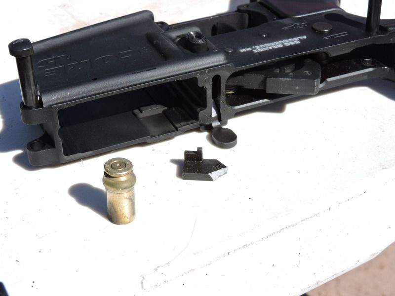

I know I'm late to weigh in, but I had a similar issue with my 10mm AR while shooting suppressed. It's a direct blow back action and I didn't have a heavy enough buffer to keep the bolt closed long enough to let pressure subside to a safe level. The suppressor didn't help matters. I now have the heaviest buffer I could find and a stack of washers under the spring to bring it closer and prevent bolt stop breaks like this too.
Interesting and thanks for adding to the discussion. Looks like you had some interesting experiences with your 10MM AR.
When I sourced out my components for this carbine I selected a buffer assembly (tube, spring, buffer) from Kaw Valley Precision that was set up for 9MM applications. The buffer has a stamp that says "7.5" so I'm guessing that's weight. Is that heavy? I don't have enough experience to say myself but it's not running a standard AR buffer and spring.
I had an unused red dot sitting around so I put it on the carbine, grabbed another 100 rounds of the FM reman ammo and went back to range. The optic was much better for me than the open sights (once I got it dialed in) and the rifle ate up the ammo without a single burp. So I've now run 200 rounds through it with only the one incident at about round 30. Hopefully this holds out to be an isolated incident.
I must say I REALLY like this gun........
Yes that should be the weight, 7.5 oz. That's heavier than a standard buffer. You should be fine and it sounds like a single bad 9mm case in your issue.
In my 10mm AR I ran over 50 rounds through it first without the suppressor, then within the next ten that happened and ended the day. The suppressor increased the back pressure and the buffer couldn't keep the bolt closed.

GONRA would sure like to know the manufacturer of the brass in DDelambre's foto.
Must be Really Good Brass to "not completely KABOOM” but just "swell up" like that!
Factory Hornady 10mm 180gr XTP. I saved the bulged brass and remaining rounds in the box with the lot number just in case it was the ammo but I don't think it is.
